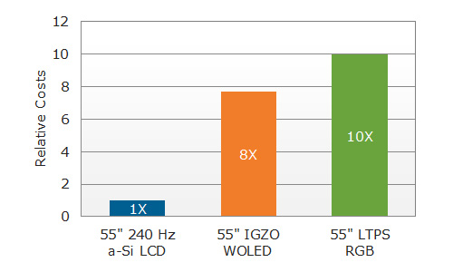

According to new numbers from NPD DisplaySearch, OLED TVs may cost 10 times as much to make over standard LCD TVs being produced today.
Recent price estimates have put OLED TVs somewhere in the $8000 range. However, the recent NPD DisplaySearch AMOLED Process Roadmap Report says that the cost of a 55-inch oxide TFT-based AMOLED using white OLED with color filters is about eight times that of a high-end 55-inch TFT LCD display of equal size. When red, green and blue OLEDĀ elementsĀ are thrown into the mix, that number jumps to 10 times. The higher costs are a result of low yields and high materials costs.

"While cost reduction in LCDs has slowed, large panel AMOLED cost reduction is in its infancy," says Jae-Hak Choi, senior analyst of FPD manufacturing for NPD DisplaySearch. "In the long-term, new and improved processes, printing technology, and higher performance materials will reduce AMOLED costs to levels equal to or lower than LCD."
Figure 1: Relative Manufacturing Costs of Technologies for 55-inch TV Panels [Source: NPD DisplaySearch AMOLED Process Roadmap Report]
