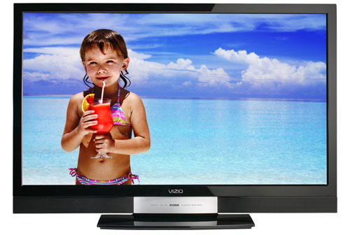

Vizio's SV471XVT makes for attractive display... except for that backlit logo.

Upon plugging in and powering up the SV471XVT, I immediately formed two first impressions. One was good, the other not so much. The latter came from the large "VIZIO" light which sits front and center below the screen. The prominent logo glows orange when the TV is in standby mode and white when the set is powered on. For the same reason I always insist car dealers leave their name badges and license plate frames off my new car, I would prefer not to see a constant, glowing reminder of who made my television. I hoped to find a menu setting which would disable this power status indicator, but no such luck. This minor irritant certainly wouldn't stop me from buying the SV471XVT, but it does blemish the face of an otherwise attractive television.

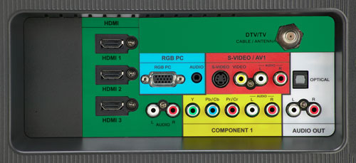

3 HDMI inputs out back plus 1 more on the side highlight the Vizio's impressive jack pack.

The SV471XVT comes well equipped to handle the bulk of your connectivity needs. On the rear jack pack you'll find three HDMI ports with a fourth conveniently located on the side panel. For analog HD connections, you get one component video input out back and another on the side panel. Composite and S-video ports are also available but if you know what's good for you you'll avoid using these at all costs. Flat panel HDTVs have a hard enough time with standard definition programming as it is. If you deliver it via composite or S-video, you're just asking for trouble. Rounding out the connections, you'll find a VGA/PC input on the back panel and a USB port on the side panel - a convenient location when connecting flash drives or an external hard drive.  I tried the former and browsed a few photos with relative ease. It should also be noted that the SV471XVT lacks internet connectivity, so you won't find an ethernet port or integrated wireless on this display.

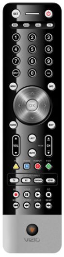

Vizio's improved remote design is a solid effort but the cursor pad still needs work.
Ergonomics and User Interface (UI) can make or break long-term satisfaction with any piece of gear - especially your television. The SV471XVT gets fair marks in this department - but they could be better. The supplied remote is well-designed and the most commonly-used controls (Channel, Volume, Source) are all smartly placed on the bottom half of the remote for convenient thumb access. The cursor pad was my only major complaint; it felt rather chintzy and was somewhat temperamental when it came to registering clicks.

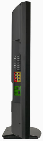

Basic controls, a fourth HDMI input and a USB port highlight the Vizio's side panel.
