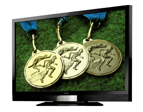

The physical design of the SV470XVT is distinctive, boasting a new esthetic with a slender piano black frame around the screen, above a convex silver center channel speaker, flanked by the black-clad left and right speakers. In addition, an optional speaker component with wireless dongle is available which, when paired with the TV's existing integrated left/right/center speakers, can provide wireless 5.1 by adding wireless rear speakers and a wireless subwoofer.  We can activate this feature via a dedicated button on the remote control.

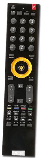

To say the VIZIO's remote didn't bowl me over would be the world's most understated sports metaphor.

  • One of the most frustratingly temperamental remotes I've ever used
