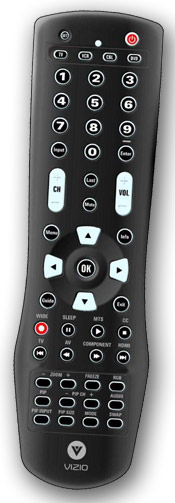

The VM60P's remote offers backlighting and a fairly intuitive button layout.
The remote control is fairly intuitive and straightforward to use, and unlike some less expensive VIZIO models, it does offer full backlighting. The entire remote keypad illuminates for a few seconds when any button is pressed. Although it does not offer direct input buttons for each input, it does offer input "type" buttons, e.g., hitting the "HDMI" button will cycle through each of the four HDMI inputs. The remote is a "universal" model in that it can be programmed to operate up to 4 different devices (DVD players, cable boxes, etc.).
Of course, the remote features the requisite "Wide" button which allows you to adjust the aspect ratio to best fit the source material, but on this set the "wide" options include a significant omission - I was surprised (and disappointed) to find that the aspect ratio control when watching the built-in ATSC tuner did not include a "normal" or "4:3" mode.
If you have any digital channel you like to watch which happens to be broadcast in 4:3 mode (e.g., PBS-Kids, The Tube, qubo, and others) then your only aspect ratio options are 16:9 (which stretches the screen to fit) and "zoom" which zooms in on the center of the screen. Neither option is ideal - one distorts the geometry of the image, the other potentially cuts off large portions of the image on each side. This "feature" also effects devices connected via HDMI and component video, when connected at 480p, 720p, 1080i or 1080p. If your source device (set-top box, cable box or satellite receiver) offers its own aspect ratio controls, then you should be fine, but not allowing 4:3 digital channels to be displayed in their proper aspect ratio via the set's own internal tuner is a pretty significant oversight.
The set-up menus are simple and straightforward. I was able to get in, get some basic picture controls tweaked, and get my local SD and HD channels added within a few minutes of opening the box, without referring to the manual. The VIZIO also offers a basic built-in HDTV program guide - hit the "guide" button on the remote, when viewing a channel on the TV's integrated digital tuner and you will see a list of the current and upcoming shows on the channel for the next several hours.
