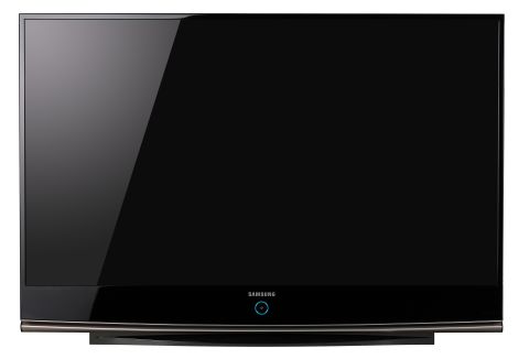

The HL61A750 is pretty from the front, A/V accessible from the side, and not even that deep around back.

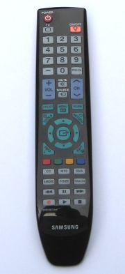

The extensively redesigned remote control is bigger, friendlier, and easier-to-use than that of its predecessors. Now the whole thing is backlit, although not as brightly, instead of a few select keys.  As more consumers are using their cable/satellite remotes or an elaborate aftermarket universal remote these days, many TV remotes end up relegated to life inside a drawer or underneath a sofa cushion without being missed.  But if you do that, you may miss the HDMI-CEC (High Definition Multimedia Interface Consumer Electronics Control) features of the remote.

The remote control has been completely redesigned for this generation.

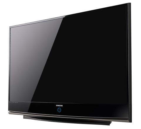

At 61 inches diagonally, this bad boy could stretch wall to wall in some NYC apartments.
