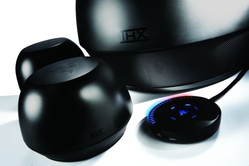

A pet project of Laurie Fincham, THX's Chief Scientist and creator of THX Ultra2, the Razer/THX Mako Advanced 2.1 Desktop Audio system is one of the big-letter company's first original product designs, and the first piece of hardware to offer Fincham's Ground Plane and Slot Speaker breakthroughs.  And as you can see from the overall look, Razer is bringing sexy back!
So compact, so curvy, and checkout those grills, yo!

The first thing you're likely to notice about the loudspeakers and sub is their roundness. While they don't approach the nigh-sphericality of Anthony Gallo's celebrated wares, they do stand out from most other speakers I've seen.  And in this case, the shape is entirely intentional, and not merely for aesthetics.
Fincham's Ground Plane and Slot Speaker technologies work together by positioning the downward-firing peerless metal dome tweeter directly atop the paper/cloth midrange and reflecting the sound off the desktop itself.  Along the way, the sound is channeled via an extremely narrow, nearly-360-degree groove (the "Slot") just above the base.  This omni-directional design lends the resulting soundfield a rich and enveloping sense of space which is missing from more traditional speaker designs.  A smaller, secondary slot, centered below the THX logo, allows the high frequencies to radiate in all directions as well.
Conventional speakers place the tweeter and midrange apart from one another in confined cabinets with narrow controlled dispersion characteristics.  This type of design minimizes the surface reflections which can interfere with the direct sound from both drivers.  But with the Mako system, by factoring in the expected desk bounce as part of the equation, the overall output of the system is substantially increased.
The distinct curves of the Mako sub and sats also defy standing waves, for greater efficiency and deeper bass.  Of course, with the desktop surface contributing toward the sound of the system, some care must be taken in placement: these speakers have no business on a rug, a mouse pad or other non-reflective surface (more on that later).
The bi-amplified satellites are driven by a proprietary ClassHD digital amplifier nestled inside the subwoofer which incorporates a "tracking power supply," essentially matching the power to the musical needs of each speaker at any given time.  This reduces wasted energy and thereby distortion, ostensibly resulting in higher fidelity.
In terms of construction, the sat housings are ABS plastic, while the subwoofer is a composite of fiber-reinforced thermoset resin and organic filler.  The eight-inch long-throw sub driver--also downward-firing--has 200 watts at its disposal, and a touch-sensitive on-desk pod wired into the sub controls it all. This remote has no moving parts and sports wicked red and blue lights that are sure to distract you while you're trying to "work."

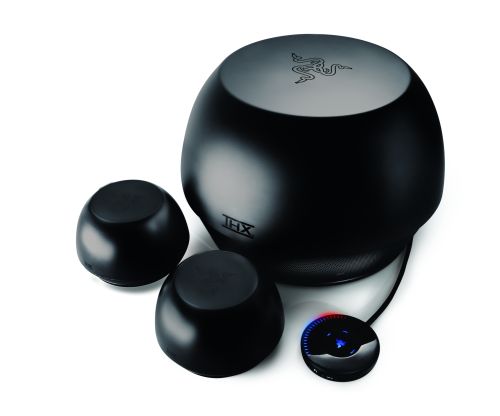

When not busy making sonic history, the Mako system does a fair Micky Mouse impression.
