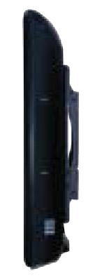

The SF640's slim design allows you to mount your TV just 1.2 inches from the wall.

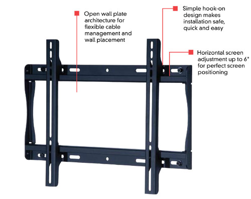

Specifications from the Manufacturer:
  • Universal mount fits screens with mounting patterns up to 17.73" W x 12.94" H
  • Open wall plate architecture allows for total wall access, increasing electrical access and cable management options
  • Ultra-slim design holds screen only 1.2" from the wall for a low-profile application
  • Horizontal screen adjustment of up to 6" (depending on screen model) for perfect screen placement
  • Universal brackets easily hook onto wall plate for fast installation
  • Mounts to wood studs, concrete, cinder block or metal studs (metal stud accessory required)
  • Comes with Peerless' Sorted-for-You™ fastener pack with all necessary screen attachment hardware
