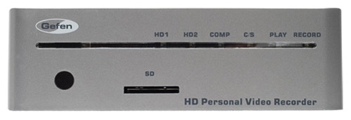

Gefen's HD Personal Video Recorder.
Although the device includes both an internal Hard Disc Drive (80 Gigabytes) and an SD card slot, copy-protected program material can only be recorded to the hard drive. It cannot be recorded to a removable SD card nor can a protected show on the hard drive be copied over to an SD card. So if you were hoping to copy over Blu-ray Disc movies to a portable media format, for playback on a portable media player, you will be disappointed.  But for non-protected material, such as broadcast and cable HDTV programming, the unit does allow you to record on either the internal hard drive or an SD card, and to copy these programs in either direction.

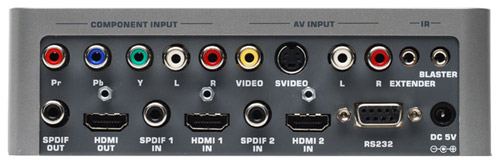

The Defen HD-PVR features a generaous jack-pack, including 1080i-capable component video and HDMI inputs.
On the video side, the recorder supports up to 1080i resolution (1920x1080 pixels, interlaced) via component or HDMI inputs, and 480i over S-video or composite video. Because the unit supports neither 1080p video resolution nor discrete surround sound, this means that the DVR does not provide transparent pass-through of the HDMI signal from source through the DVR to display. In other words, if you insert the DVR into the signal chain, between source component and your display or receiver, you'll be limited to two-channel (stereo) sound and 1080i resolution from your source device.  A workaround for this would be to use the component video and 2-channel analog audio output on your source device to feed the Gefen DVR, instead of HDMI.  But this assumes that your source component supports concurrent output over digital and analog audio and video outputs (not all components do).

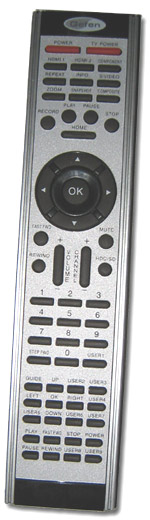

The HD PVR's remote suffers from odd button layout and no backlighting.

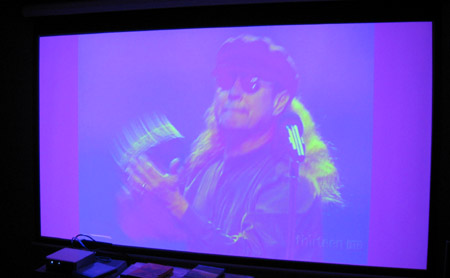

Switching over to the afore-mentioned Sony HD tuner as the source, flipping through the various over the air digital channels in New York City, the Gefen recorder would not lock on SD digital sources (480p). Switching over to true HD sources then had a red tinge to the picture. This color shift affected only what was visible on-screen coming in via a live signal. Oddly enough, it did not affect recordings made even while this color shift was visible on screen. Upon later playback it was evident that these recordings were fine. Power on/off solved that problem.
After a few upgrades of the firmware, finally at firmware 1.0.9a, the red tinge problem went away. It still took the unit several seconds to lock to a non-HD digital channel, but the HD channels were no longer tinged red after the final firmware upgrade.  Also, it's important to note that this only occured via HDMI (not component) and only with the Sony DHG-HDD500 HD DVR as a source, so this problem may never affect the average user.

In day to day operation, the Gefen's remote control was not very intuitive. The button layout was unlike anything I've seen before, with some transport controls above the center 4-way control pad area and some below it, all identically shaped and not very logically laid out. Fast forward and rewind buttons were stacked vertically, for example, right next to the volume up/down button, and a completely separate set of transport buttons are included at the very bottom of the remote, apparently intended to control some other device because they have no effect on playback on the Gefen.

Seeing red! Until upgrading the Gefen unit to the latest firmware, an odd red tinge affected the screen after flipping though standard def channels using a Sony HD tuner as the source for recording.
