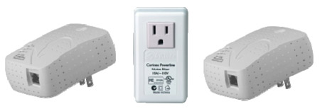

The High Definition Video Connectivity Kit contains 2 Corinex AV200 Powerline Wall Mount adapters and a Powerline Noise Filter. The filter can increase the performance of any Powerline network by eliminating electrical noise in the home wiring from devices such as hair driers or vacuum cleaners. If you don't need the filter, or if you want to buy additional AV200 extension boxes, you can get the AV200 Powerline Wall Mount - Dual Pack for a little less money. It's identical to the High Def Video connectivity kit but without the filter.
The Corinex High Definition Video Connectivity Kit includes two AV200 powerline networking boxes plus a power filter which can reduce AC line noise.
