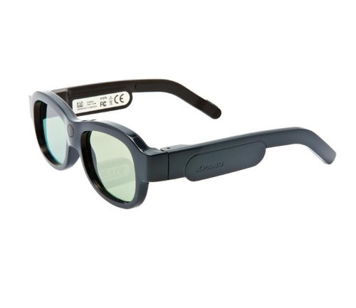

XPanD Youniversal 3D Glasses (aka, Model X104) - these are universal 3D glasses that work with multiple different brands of IR-based 3D TVs and projectors. We've confirmed that these also synch quickly with the PT-AE8000U and produce a pleasing 3D image. Unfortunately, they're also pretty expensive ($99 list price), but some sellers on Amazon have the small-sized version (for kids or adults with smaller heads) for under $10. You can even buy an RF dongle that will convert them to RF glasses to work with the newer 3D TVs and projectors. Those dongles are getting a bit harder to find though.
XpanD's X104 Universal 3D glasses work with most IR-based 3D displays. An optional RF dongle can be added for even greater compatibility (not required for Panasonic projectors).
The XpanD Youniversal 3D glasses are light and comfortable to wear but are bit too small to fit over prescription glasses easily. Also, they are more open than the other XpanD glasses so ambient room light may be distracting.

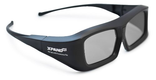

XPanD X103 3D glasses for Panasonic - these are XPand glasses made specifically for IR-based Panasonic 3D TVs and projectors. Be careful here because there are several different versions of the X103 glasses, some of which are proprietary to specific brands. You want the Panasonic-specific version (model number X103-P2-G1 for a single pair, X103-P2-G2 for the 2-pack). We found these selling on Amazon (sold as "used," but with a warranty and in the original packaging) for under $12/pair. We tested them and found them to work great with the PT-AE8000U.
Other variations of these X103 glasses only work with specific manufacturers (e.g. JVC or HP) so be careful what you buy. We also tried the universal X103 model, and, although it did sync with the TV, the 3D image had bad ghosting (crosstalk). For this reason, we'd only recommend the Panasonic-specific version of the XpanD X103 glasses for use with the Panasonic projector.
These XpanD 3D glasses are made specifically for Panasonic 3D TVs and projectors.
The XPand X103-P2-G1 3D glasses for Panasonic offer a nice field of view, good isolation from room light and are reasonably light and comfortable. They are large enough to fit over most prescription glasses.
