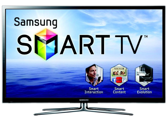

Samsung's E8000 plasma series is a strong performer with an excellent feature set.
Both the Samsung and Panasonic sets include a wealth of "Smart TV" features, including all the big streaming services: Netflix, Pandora, Amazon VOD (new to Samsung in 2012), VUDU, Hulu+ and much more. Both sets include built-in WiFi support and DLNA so you can wirelessly transmit 1080p video from recent Smart Phones.  I tested this on the Samsung using a Samsung Galaxy SIII and was able to view the videos shot on my phone in HD on the set easily, without any wires.  But you can also get the WiFi and streaming services for under $100 from a Networked Blu-ray player, Roku or Apple TV box. Unfortunately neither manufacturer offers a stripped down "monitor-only" version of their top of the line panels so you're going to get things like streaming and 3D capabilities whether you want them or not (the good news is, you don't have to use them).
Samsung included some interesting control options, namely voice control and gesture control on its high-end sets in 2012. But in my experience, these are fairly gimicky and really don't work that reliably. Sure, it's fun to play "Angry Birds" on the Samsung sets with your hand as the controller, but after a while your arms get tired and the novelty wears off. Also, with the voice and gesture-controlled features enabled, I found that the TV would sometimes turn itself on when no one was around. Maybe the neighbor was shouting "HI TV POWER ON" really loud, just to mess with us?

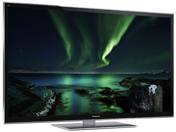

If I had to pick one winner, I'd have to pick the Panasonic VT50, again going back to those sweet inky black levels. On the opening credits of "Blade Runner: The Final Cut" on Blu-ray, the white and red text emerges from a jet black background with absolutely no ghosting or haloing. The black background is really black without any hot-spotting around the edges of the screen or anywhere else. On the Samsung it's nearly as impressive but just a hair lighter on the background. To me, a dark, consistent black level is really what makes a set look "3D," without the need for glasses or special content.
Panasonic's VT50 plasma offered the best black levels of any TV in 2012.
