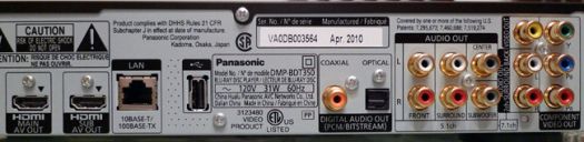

One issue you will be faced with, assuming you want to take advantage of the 3D capabilities of the player, and you are using a home theater receiver or preamp/processor for your sound, is that you do need a 3D-compatible receiver.  3D passthrough capability is part of the HDMI 1.4 spec, which was only recently finalized, so most receivers with 3D passthrough were only released in 2010.  With one of these new receivers, you can connect your player to the receiver, and the receiver to the TV, both via HDMI, and happily go about your business.  But if you've got an older HDMI receiver, then don't fret.  The Panasonic DMP-BDT350 is one of only a couple on the market that includes dual HDMI outputs -- one can be connected directly to your 3D display for 3D video, and the other can be connected to your receiver or preamp/processor for audio duties.  If connected this way, you will need to disable the video output from the secondary HDMI output, which you can do from the player's set-up menu.  We connected the player this way successfully, though our Integra DTC-9.8 preamp/processor did introduce some of its own challenges, but nothing caused by the player.

The BDT350 offers multi-channel analog outputs as well as dual HDMI outputs for compatibility with old and new A/V receivers and home theater systems.
Another unique feature of the DMP-BDT350 is its multiple 3D output options: it offers the standard Blu-ray 3D frame-packed output, plus side-by-side and checkerboard 3D outputs.  "Checkerboard" is the most interesting, because it allows this player to work directly with the 3D-ready DLP TVs offered from Mitsubishi and Samsung since 2007 as well as a handful of early 3D-ready plasma TVs offered by Samsung between 2008 and 2009.  We tested the checkerboard output with Samsung's 2008 model PN42A450 and found that it was able to create a pleasing 3D image, albeit with some crosstalk and a lower resolution than today's full HD 1080p 3D TVs.

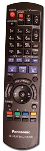

Panasonic seems to spend the bulk of their energy on improving the audio and video playback performance of their players, and for that we applaud them.  However, they need to start concentrating more on the ergonomics and usability of their players.  While competitors such as LG and Samsung offer nice graphically-driven user interfaces for navigating the various types of content and settings, Panasonic still relies heavily on basic text-driven menus.  And with all the tweaks available for picture, sound, and networking, there are an imposing amount of settings and parameters available inside the set-up menus

While the remote lacks backlighting, it is fairly comfortable in the hand.
