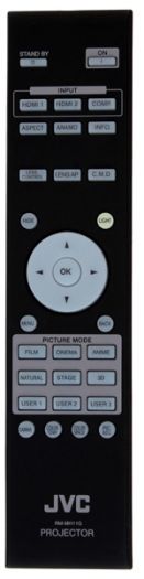

The X3's remote
It's got direct input buttons and an amber backlight activated by a glow-in-the-dark button. This is how you make a remote.
