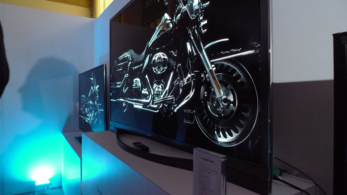

Samsung F8500
The F8500 plasma HDTV wowed crowds at Samsung's 2013 TV launch party in lower Manhattan.
As for the black level improvements, Samsung engineers attribute this to the newly enhanced "carbon nano" filter called "Real Black Pro" which coats the glass of the plasma screen. This isn't simple "window tint" that makes everything darker, but a specially designed formula and screen structure which passes light outward from the TV transparently while absorbing ambient light in the room. This allows the blacks to stay dark without being washed out by ambient room lighting. If you have bright lights directly behind your viewing area you will see some light reflected by the screen but it's fairly diffuse and greatly minimized compared to a plain glass screen.  Improvements made this year to the filter's efficiency (its ability to pass light to the viewer) actually improve brightness as well, so the filter contributes to both the better blacks and brighter whites.

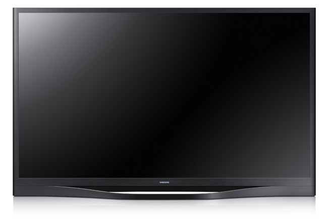

Samsung F8500 Plasma from side
The F8500 plasma's Real Black Pro filter minimizes light reflection on the screen.
