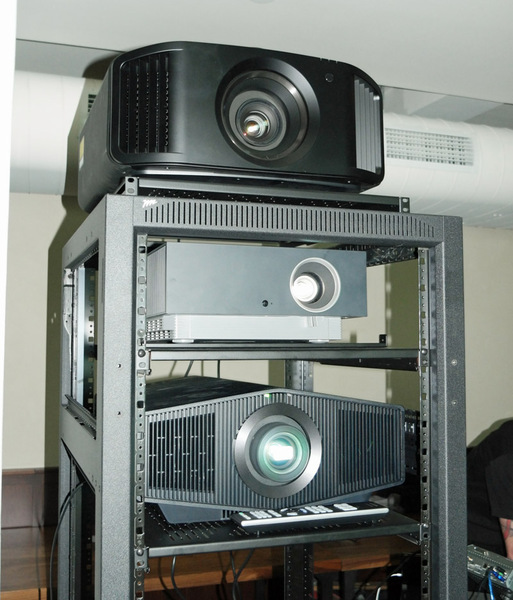

Projectors from JVC, LG and Sony in the 2022 Projector Shootout.

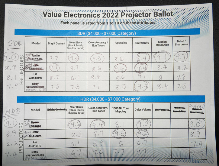

With such a range of different technology on display, clear differences emerged among these projectors. The LCoS-based Sony and JVC projectors offered better black levels and contrast than the competitors (particularly the LG). The Sony's laser light produced visibly higher brightness than the JVC's traditional lamp, but at the expense of color accuracy (whites and skin tones looked slightly blue-ish on the Sony projector). On native 4K content, the two pixel shifting projectors (LG and Epson) exhibited some visible pixel structure, but only when we got much closer to the screen than one ever would during normal viewing.
The Epson projector was almost able to keep up with the more expensive JVC and Sony projectors in contrast and black levels and also put in a pretty strong showing for color accuracy and skin tone reproduction. Where the JVC and Sony projector really shined was in overall color volume and color saturation. This, combined with the superior black levels separated the two top performers from the pack.
Each of the projectors is a strong performer at its price point, but it seems in some cases you do "get what you pay for" and this was reflected in the results.
The final rankings in the $4,000-$7,000 category were:
  1. JVC DLA-NP5: 9.0 points - The winner!
  2. Sony VPL-XW5000ES: 8.9 points - second place
  3. Epson LS12000: 7.7 points
  4. LG AU810PB: 7.4 points
Scorecard from the Projector Shootout, price range $4000 - $7,000.

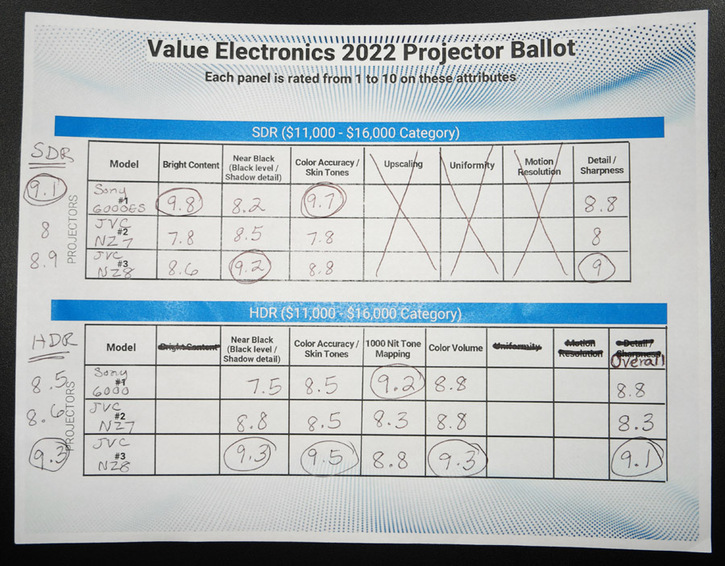

As in the lower price range, it was a close competition between a JVC and a Sony projector. The Sony XW6000 took the top score in three categories (bright content, SDR color accuracy and tone mapping) while the JVC NZ8 took first place in SDR shadow detail, overall detail, HDR shadow detail, HDR color accuracy and HDR color volume. Once again, a JVC took home the gold in the $11,000-$16,000 price range with Sony coming in close behind it, at a significantly lower cost.
Final Scores for Home Theater Projectors ($11,000-$16,000)
  1. JVC DLA-NZ8: 9.1 points
  2. Sony VPL-XW6000ES : 8.8 points
  3. JVC DLA-NZ7 : 8.3 points
Scorecard from the 2022 Long Throw Projector Shootout, $11,000-$16,000 price range.

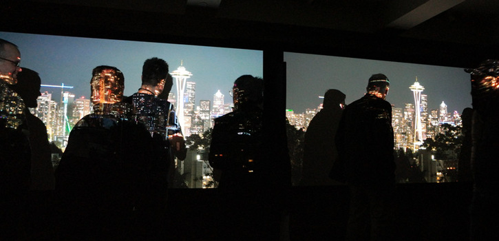

Judges lean in for close examination of both projectors' performance in the final round of the 2022 Projector Shootout.

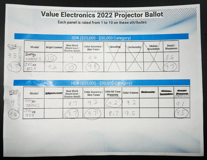

In this final category, the Sony projector earned a perfect 10 for bright content testing, with excellent highlight detail in test patterns and demanding real-world content. It also outscored the JVC projector in 1000-Nit tone mapping tests on HDR content. But the JVC projector earned a perfect 10 for SDR shadow detail, and earned slightly higher scores than the Sony for SDR and HDR color accuracy as well as HDR shadow detail. While it was a very close race, JVC managed a clean sweep, earning the highest overall scores for all three price ranges in the competition.
Final Scores in the $25,000-$30,000 price range
  1. JVC DLA-NZ9: 9.5 points - 3-Chip 4K D-ILA Projector with Laser Lighting and 8K eShift ($25,999)
  2. Sony VPL-XW7000ES: 9.1 points - 3-Chip 4K SXRD Projector with Laser Lighting ($27,999)
Scorecard from Projector Shootout, $25,000-$30,000.
