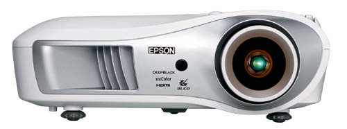

Measuring in at 4.8 x 15.6 x 12.8 inches (HxWxD) and weighing 12 pounds, the 1080 UB is noticeably smaller and lighter than the Panasonic and Sanyo 1080p projector offerings, and this makes integration into a living room or home theater a simple matter. It can sit on a bookcase or coffee table or be placed in a more traditional rear shelf or ceiling mount. Its white color works particularly well with a ceiling mount, but its curvy elegant lines won't be intrusive in plain sight.
Epson's Home Cinema 1080 UB 1080p 3-chip LCD Home Theater Projector.

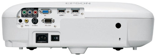

In terms of inputs/outputs, the 1080 UB is generous enough with 2 HDMI 1.3 inputs and one each of component video, S-video, composite and VGA/DB15 (for a PC or Mac). It's likely that most people will use just one or two of these and allow their receiver, video processor or video switcher to switch between multiple sources (in order to minimize the need for multiple long cables) so this jack-pack should be more than adequate for most purposes.

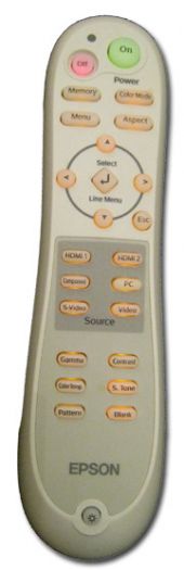

The 1080 UB's remote features direct input access and full backlighting at the touch of a button.
Ergonomically Correct

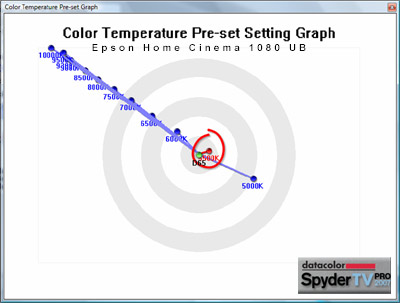

The 1080 UB's remote and menus were extremely easy to navigate. During calibration, I appreciated having "Color Temp" and "Contrast" buttons right on the remote. This made adjusting these settings simple (no need to go back in and out of the sub-menus over and over). With no less than twelve different color temperature settings (from 5500 to 10000 K), this would have been tedious to navigate had the color temp settings only been available via a deep menu option. I only wish they had done the same with the Brightness, Color and Tint settings, but the menus were pretty simple for these options so getting in and out to do the adjustments wasn't so bad.
In addition to these buttons, the remote includes full back-lighting for all keys, direct input buttons for each input, "Aspect" and "Color Mode" buttons plus a few other picture controls and, of course, the Menu and Navigation buttons, all of which were fairly logically laid out.  The projector does not have a "vertical stretch" aspect mode so if you want to use this with an anamorphic lens for a fixed height ultra-wide screen installation you'll need an outboard processor to do the anamorphic squeeze.

On our white screen the "5500" color teperature setting measured the closest to the 6500 Kelvin standard.

Epson Home Cinema 1080 UB - jack pack.
