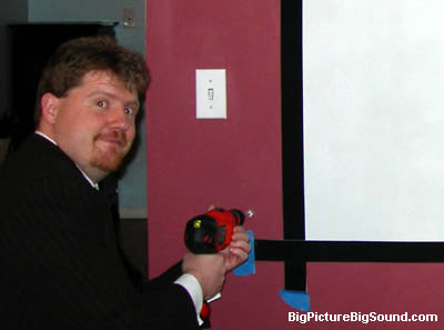

Wall-mounting your speakers will help give your home theater a professional, finished look, but maybe take off the business suit before the painting begins.
Next up in Part III, we tried out a lower cost, more easily obtainable latex paint from Behr called "SilverScreen." Behr paint is available at paint stores and Home Depots across North America. It's inexpensive, and easy to apply. We mated the Behr up with Visual Reality's "Flok" tape - a dense pile black tape, available in 2-inch and 3-inch widths. The Flok tape goes on your wall almost as easily as masking tape, and presents a nice finished border for your screen, accentuating contrast and color saturation. The Behr SilverScreen paint certainly offered an improvement over the previous beige wall, but did not quite offer the clarity, detail or vividness of the Screen Goo.
