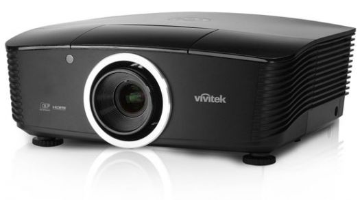

Vivitek may be a name unfamiliar to many home theater shoppers, but that's something the projector maker is hoping to change. Historically a business- and education- focused projector company, and comprised largely of former employees of BenQ and Optoma, Vivitek has been ramping up their efforts to be more competitive in the home theater marketplace. Exhibit A is Vivitek's H5080, a 1080p DLP-based home theater projector.
Positioned between Vivitek's entry-level H1080FD and their flagship H9080FD (the "world' first LED 1080p home theater projector"), the H5080 is a bright, well-equipped, and capable performer packing a zoom lens and both horizontal and vertical lens shift adjustments to ensure installation flexibility.

Vivitek's attractive H5080 features concealed lens shift knobs on its top - a mixed blessing.

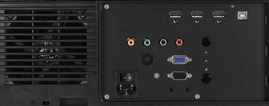

Connection options on the H5080 are surprisingly robust. That HDMI cable Vivitek gives you can be plugged into any one of the three HDMI inputs you'll find out back. There you'll also find one component video input, one VGA DB15 input, one S-video input, and one composite video input. You'll also find a USB port out back, but this is reserved for service and firmware use only. Last but not least, an RS-232C serial data port and dual 12V triggers round out the offerings on the rear jack pack.
As previously mentioned, the H5080 features both vertical and horizontal lens shift adjustments: something we don't see often enough on projectors, particularly on lower cost DLP projectors. This provides much greater installation freedom, as you don't need to be as careful when you're positioning your projector in relation to your screen. With projectors featuring dual axis adjustments such as those on the H5080, "close enough" is usually good enough. Once you've picked your spot, simply adjust the two lens shift knobs until your projected image is properly centered on your screen.
Alas, Ergo
On the subject of those lens shift adjustment knobs, this is one area where the H5080 loses points in the ergonomics department. Whereas many projector manufacturers leave their lens shift adjustment wheels exposed, Vivitek chose to conceal theirs beneath a sliding door on the unit's top surface (facing down if you ceiling-mount the unit). Although this out-of-sight approach sounds good in theory, the access door is somewhat finicky to open. The net effect is that you sometimes apply so much pressure trying to open it, that you inadvertently push the projector off center and have to re-align it. Granted, you shouldn't have to make lens shift adjustments too often, but the physical logistics of these adjustments could definitely be improved.
Like most projectors, the H5080 features a hard Power switch on the rear of the unit. This is left on most of the time as the projector remains in a low-power standby state waiting for its next assignment. One minor nitpick: the soft Power button - responsible for waking up or powering down the unit - is inexplicably given the same inconvenient rear panel location. This hard-to-reach, impossible-to-see button is less than ideal if your projector is ceiling-mounted, and even worse if you plan to use a shelf mount on your theater's rear wall. Here's hoping future models see this button moved to the top, where Vivitek does have other function and source toggle controls. On the plus side, Vivitek does give us both front and rear infrared (IR) receptors to give remote control commands the best chance of registering.

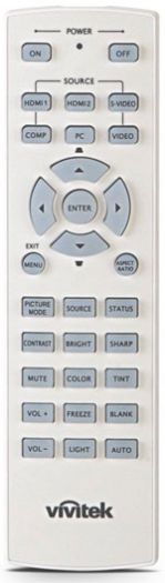

As for the remote control itself, Vivitek's remote is an all-white affair with a brilliant blue backlight. Mine was temperamental in that sometimes the first button press would fail to illuminate the keypad, but more often than not it worked as advertised. Thankfully we get direct source selection buttons so you can quickly switch between HDMI, component video, etc.

Three HDMI ports, one component video, and USB - nice. But why is the (soft) Power button back here?
