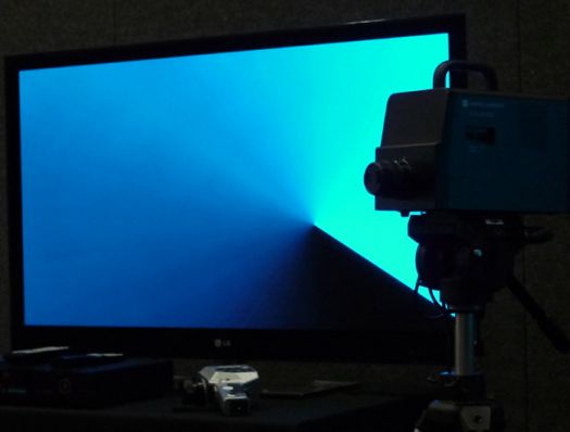

These spinning circles of fine lines help reveal deficiencies in video processing.
This chroma gradation test helps reveal processing problems that would cause banding in transitions from light to dark.
