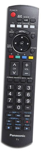

The PZ800 series remote control lacks backlighting but it's logically laid out so most functions are easy to find by feel.

The remote control is a basic non-backlit unit with some transport controls for operating a VCR, cable box, DVD or Blu-ray Disc player. Although it lacks direct input buttons for each of the 10 inputs, it does not require that you scroll through all of the inputs to get to the one you want. Instead you can hit the "TV/Video" button then the numeric input corresponding to the input you want. For example, hitting "TV/Video" then "4" will select the HDMI 1 input (the fourth input on the list). This makes programming a universal remote to operate the TV a little simpler and more fool-proof.
