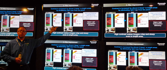

Each manufacturer with a set (or two) on the wall had a few minutes at the beginning of the event to highlight the design or feature set of their respective TVs. Some reps kept it high level, mostly going over features, while others drilled down into the technology, but never too deeply. The representatives were mostly trainers, not design engineers or sales reps and so walked the line between marketing hyperbole and a deep technology dive fairly well.
Gregg Lee, Panasonic
Panasonic's Senior Manager of Training, Gregg Lee highlights the new technology in Panasonic's 2012 HDTV line... while gesturing to a Samsung plasma.

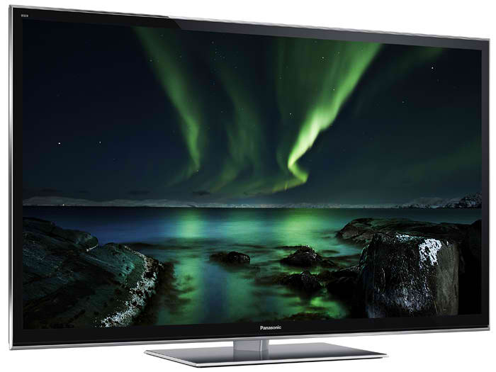

Overall, given the material and test patterns, and assuming that the calibrations were all performed fairly and that none of the sets were defective, my favorite-looking set in this year's shootout was the Panasonic VT50 plasma.  Only the Samsung plasma put up a real fight here. Of the LED sets, the ELITE was still the best-looking with inky black levels (but virtually no haloing or spotlighting).  As far as LED/LCD sets, the ELITE model is an impressive piece of gear.
This year's winner of the Value Electronics HDTV Shootout, the Panasonic TC-P65VT50.
