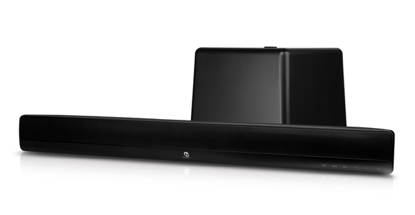

I just recently got a Samsung LED TV.  It looks great but sounds terrible.  So I picked up a sound bar.  It's a Boston Acoustics TeeVee 26 and came with a subwoofer too.  So what's the best way to connect the sound bar up to the TV and the sub? I want to get the best sound.

In terms of how to hook up a soundbar to a TV, there are usually a couple of choices. Many sound bars these days come with a digital (usually fiberoptic) input and an analog input. Your Boston Acoustics TVee Model 26 has a fiberoptic digital input plus two 3.5mm aux inputs (which look like headphone jacks). For best results and simplicity, I would suggest using the fiberoptic digital input. So plug an optical digital cable from the TV's digital audio output to the sound bar's digital input and you'll be good to go.
The Boston Acoustics TVee 26 will accept both optical digital and analog inputs so you can enhance TV sound and also listen to music from your phone or tablet.
