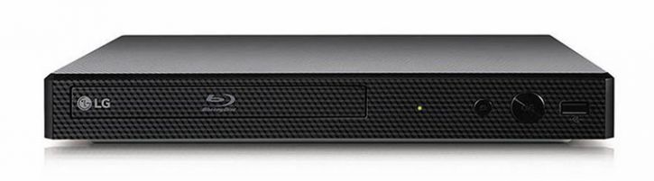

Inexpensive Blu-ray players that support bitstream output of Dolby TrueHD soundtracks, like this LG model, should work perfectly with the new Dolby Atmos and DTS:X Blu-ray titles.

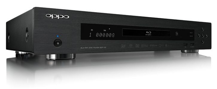

I say, "should" because there are some exceptions. Some of the earlier OPPO Blu-ray players like the OPPO BDP-83, BDP-93 and BDP-95 (for example) have problems with Blu-ray Discs that use a feature called "seamless branching" combined with a Dolby TrueHD soundtrack. Seamless branching is a method used by DVD and Blu-ray players to branch from one scene to another scene that may be on another part of the disc (not in physical order). Some of the Dolby Atmos titles currently on the market do use seamless branching, and so they have audio dropouts when played back on a player that doesn't support seamless branching properly. Happily the issue does not affect OPPO's later players (BDP-103, BDP-105). I use an OPPO BDP-103 for Dolby Atmos playback with no problems whatsoever.
There was previously a workaround for this issue on affected players: switch the player to "PCM" decoding mode, and you could avoid the drop-outs without sacrificing sound quality. But since Dolby Atmos and DTS:X require the player to be in bitstream mode, this is not a viable workaround.
While OPPO's earliest Blu-ray players have issues with seamless branching, their latest models such as the BDP-103 do not, making them excellent choices for Dolby Atmos and DTS:X playback.

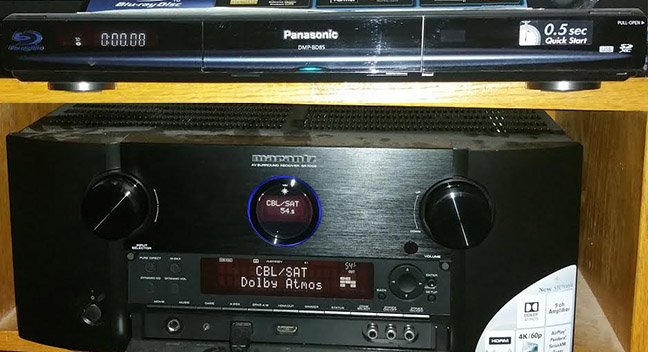

This Panasonic Blu-ray Player from 2010 (Model DMP-BD85) supports Dolby Atmos perfectly when set to bitstream its output to this Marantz receiver.
