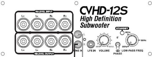

The CVHD (Cerwin Vega High Definition) 5.1 system installs pretty much like any other home theater speaker system. Each satellite speaker comes with high quality heavy duty binding posts which accept bare wire, spade lugs or banana plug connectors. The powered subwoofer comes with an RCA input to connect to your receiver or preamp's LFE (low frequency effects) or subwoofer output. You might need to experiment with subwoofer placement in your room for best effect, but this is true for any subwoofer. For details on subwoofer set-up see our tutorial on subwoofer set-up.
Once I found the best location for the sub, I used our Onkyo receiver's built-in Audyssey 2EQ calibration system to set the levels and crossover frequencies inside the receiver, leaving the subwoofer's own crossover setting pegged at the 150 Hz position. For those without an auto-calibration utility, Cerwin Vega recommends setting both the satellite speakers and the subwoofer crossover to 150 Hz.
If your receiver or processor does not allow you to set the crossover this high, then the manufacturer recommends using the speaker level inputs on the subwoofer instead and setting your front speakers to "large" in your processor's or receiver's speaker set-up menu.  In this case, the subwoofer's own internal crossover will receive the full frequency signal from your receiver's left and right speaker output, routing the bass frequencies to its on-board amp and 12" driver and passing the midrange and high frequency signals on to the main left and right satellite speakers. The subwoofer's variable level and crossover controls and phase adjustment will allow you to tweak the system for the best sound in your particular room.
The CVHD-12S powered subwoofer offers line level and speaker level inputs, adjustable phase, volume and crossover level controls so you can optimize the system for your specific environment.
