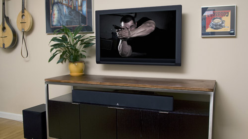

Atlantic Technology's FS-7.0 can fit under a flat panel or be mounted on the wall.
